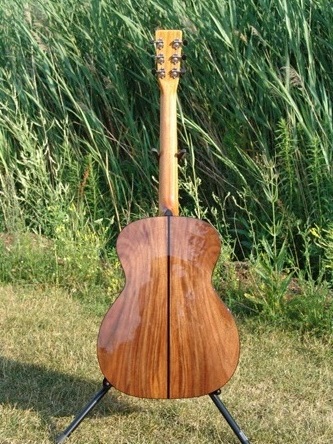

Thanks Bob, i'll definitely buy a set from you soon, gorgeous stuff to my eyes!
I own a beautiful walnut OM-H that has a very bright and ringing sound, the figure in it reminds me of Angel wings! Thanks to my bro Hesh!

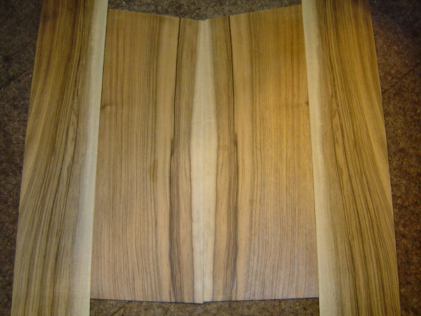

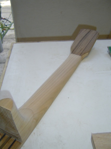

Sam, English Walnut makes a beautiful guitar which is fairly neutral in tone allowing the top to express itself without too much colour. I'm currently working on one with an Italian spruce top. Russell recently posted one using a sister set.
This is the set I'm using (only got three more )
Cherry is a fine tone wood as well, though this should be the native Prunus avens, rather than the domesticated species. I've only used it for necks so far as this is the timber I've got, My 8-course lute used it as is the Walnut OM I'm making, head and tail block as well. Russell also uses it a lot for necks.

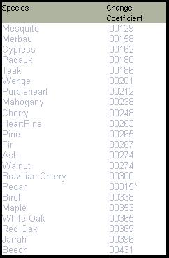

I agree with JimW and PaulB. Learn about the
properties of the wood you build with.
If you know the Coefficient of dimensional change
you can get an idea of how stable the wood is.
Coefficient of dimensional change relates to what happens when there is a change to the moisture content
of wood. The lower the number, the less wood moves
with humidity changes.
Tom
